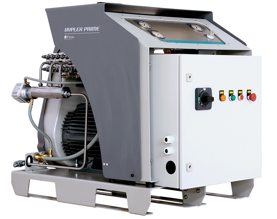

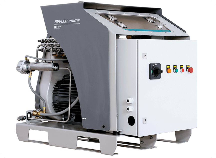

60,000 psi [4,150 bar] Direct Drive Pump
The HyPlex® Prime pump represents the next generation of energy efficient, direct drive ultrahigh-pressure waterjet pumps. The HyPlex's direct drive delivers superior ratio of input energy to the waterjet.

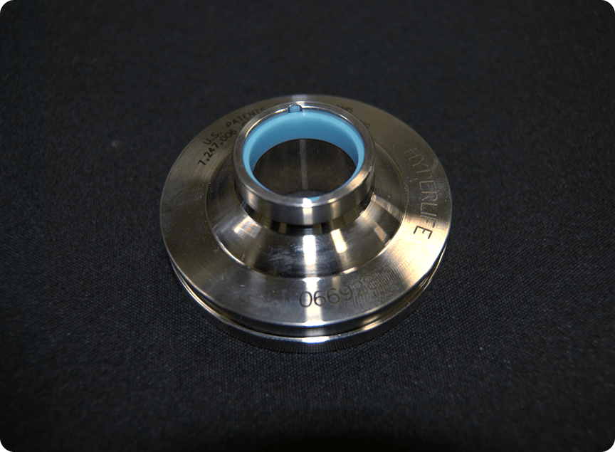

Next Generation Seal Technology
Utilizes the next generation of seal technology from Flow’s 94,000 psi HyperPressure™ pumps.

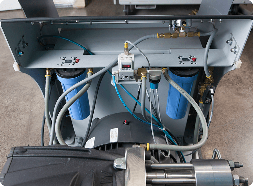

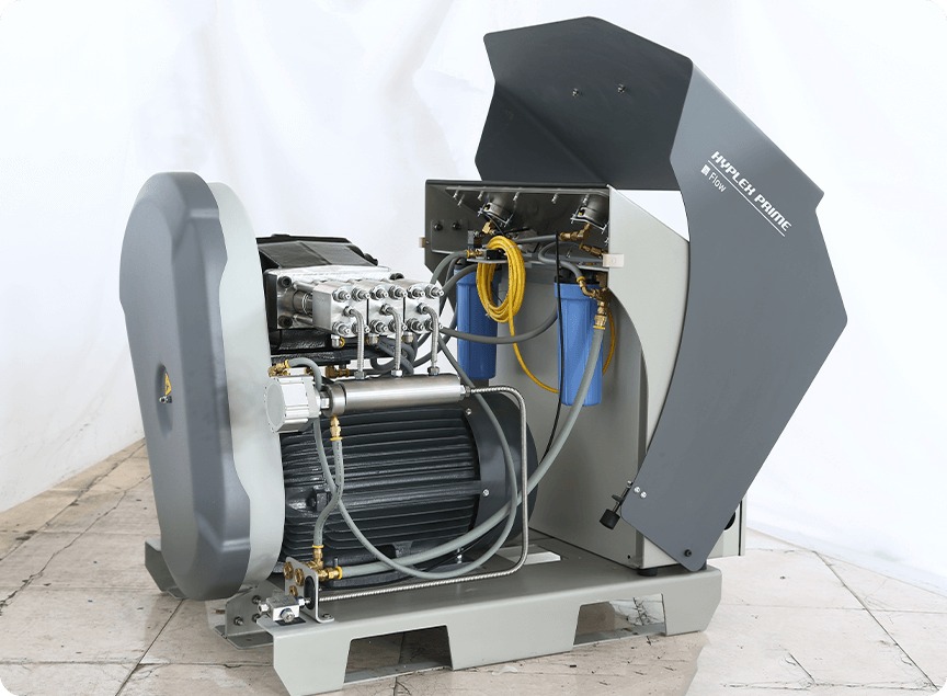

![Modular Pump Design | HyPlex Prime with built in fork pockets](https://www.flowwaterjet.com:443/getmedia/f59179d1-5dbc-41c2-b6bc-8a872e206a62/hyplex-prime-modular-design.png)
Modular Pump Design
Allows for a wide variety of options such as dual-pressure control. The HyPlex Prime is mounted on its own purpose-built skid for mobility, vibration isolation, and ease of service.
