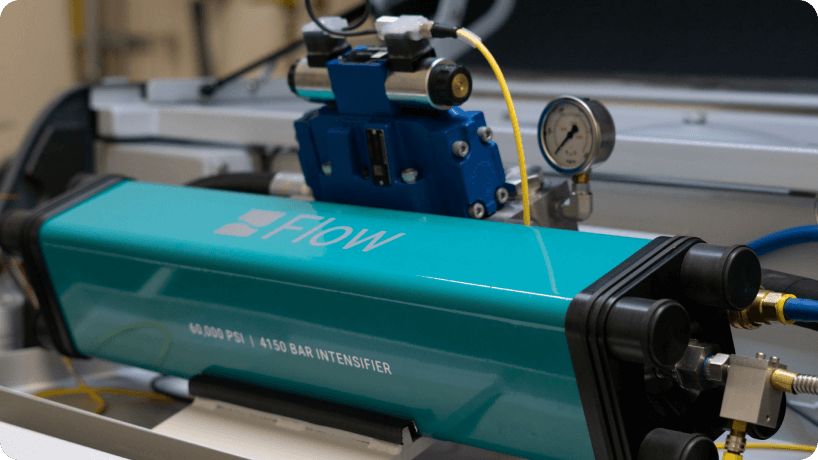

The concept of waterjet is quite simple. Here's how it works:![Flow 60,000 psi intensifier](https://produse2webst.blob.core.windows.net/cms/flowwaterjetcom2022/media/explore/waterjet%20basics/how%20waterjet%20works/1-pressure-how-waterjet-works_1.png)
1
Generate Pressure
An ultrahigh-pressure pump generates a stream of water with pressure rated up to 94,000 psi (6,480 bar). To put it into perspective, a fire hose contains a pressure of 390 to 1,200 psi (20 to 84 bar).

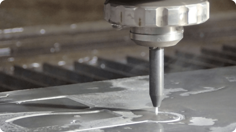

![Waterjet cutting head cutting metal](https://produse2webst.blob.core.windows.net/cms/flowwaterjetcom2022/media/explore/waterjet%20basics/how%20waterjet%20works/2-velocity-how-waterjet-works_1.png)
2
Convert Pressure into Velocity
This pressure is converted into velocity via a tiny jewel orifice, creating a stream as small as a human hair which can cut soft materials.

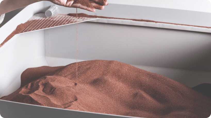

![Hand with garnet flowing through above an abrasive hopper](https://produse2webst.blob.core.windows.net/cms/flowwaterjetcom2022/media/explore/waterjet%20basics/how%20waterjet%20works/3-garnet-how-waterjet-works_1.png)
3
Introduce Garnet
To increase cutting power by 1,000x, garnet is pulled into the supersonic waterjet stream. Water and garnet exit the cutting head at nearly four times the speed of sound, capable of cutting steel over one foot thick.

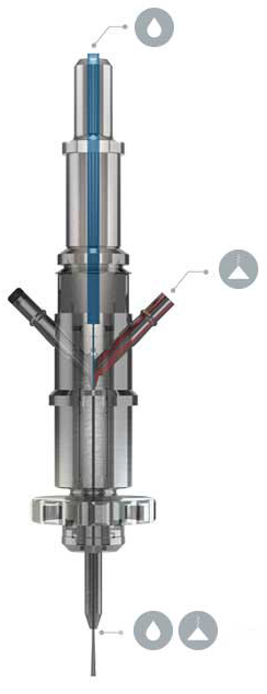

Pure & Abrasive Waterjet
There are two types of waterjet: pure and abrasive. Combined, these two technologies can cut virtually any material, any shape, at any thickness.![Rendering of a waterjet cutting head cross section showing water and abrasive flow](https://produse2webst.blob.core.windows.net/cms/flowwaterjetcom2022/media/explore/waterjet%20basics/how%20waterjet%20works/the-basics.jpg)

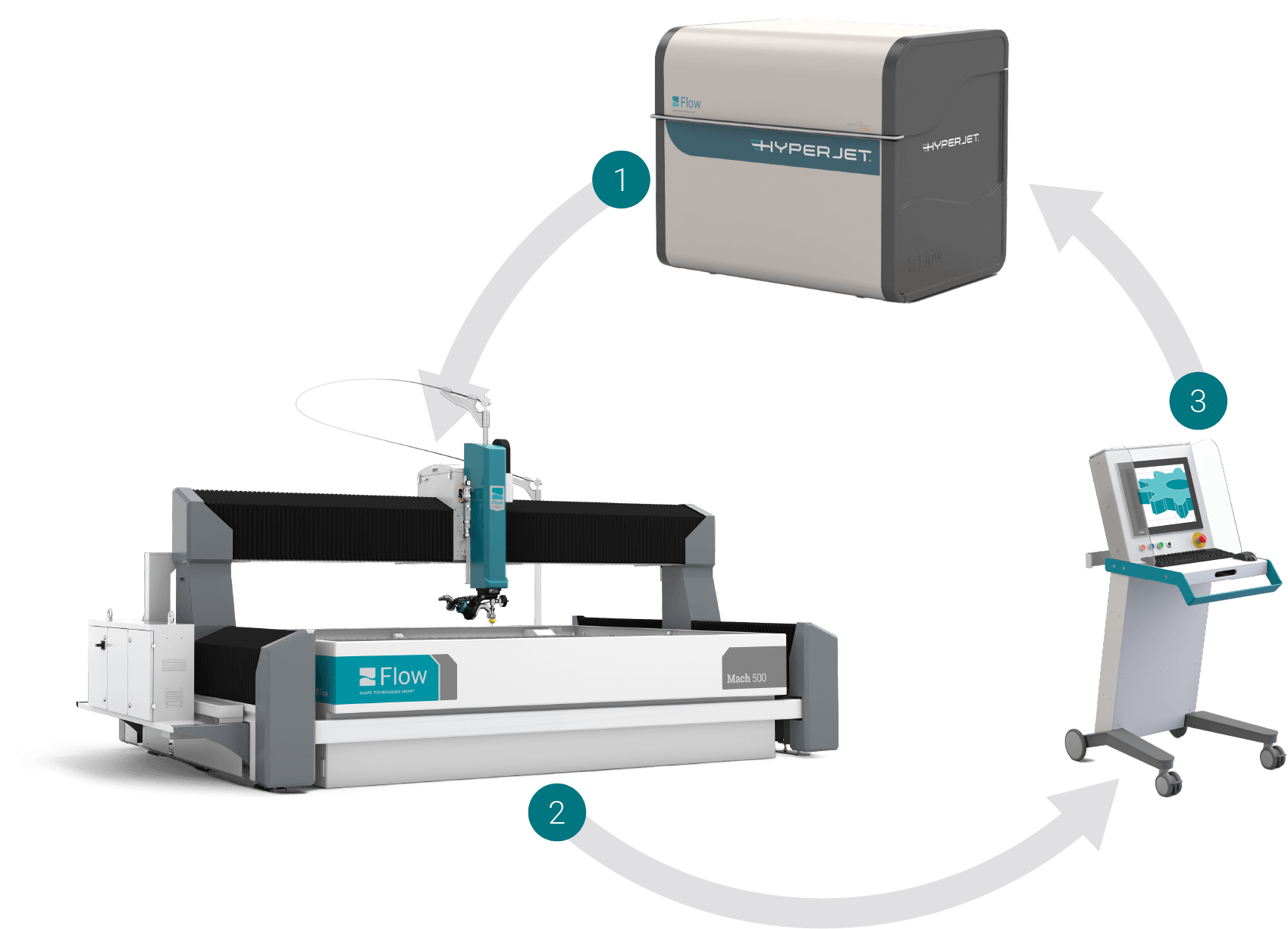

Components of Waterjet
A waterjet is more than just pressurized water and sand. The shapecutting system is comprised of:![Integrated image of 1. Flow waterjet pump 2. Flow waterjet system 3. Flow operator interface](https://produse2webst.blob.core.windows.net/cms/flowwaterjetcom2022/media/explore/waterjet%20basics/how%20waterjet%20works/components-of-waterjet.png)
1 |
The Ultrahigh-Pressure System includes the pump, cutting head, and plumbing |
2 |
The Machine includes the X, Y, Z axes, cutting head wrist axes, and material support catcher |
3 |
The Control System includes the programming software, operator interface, drive motors, and position and velocity feedback system |
