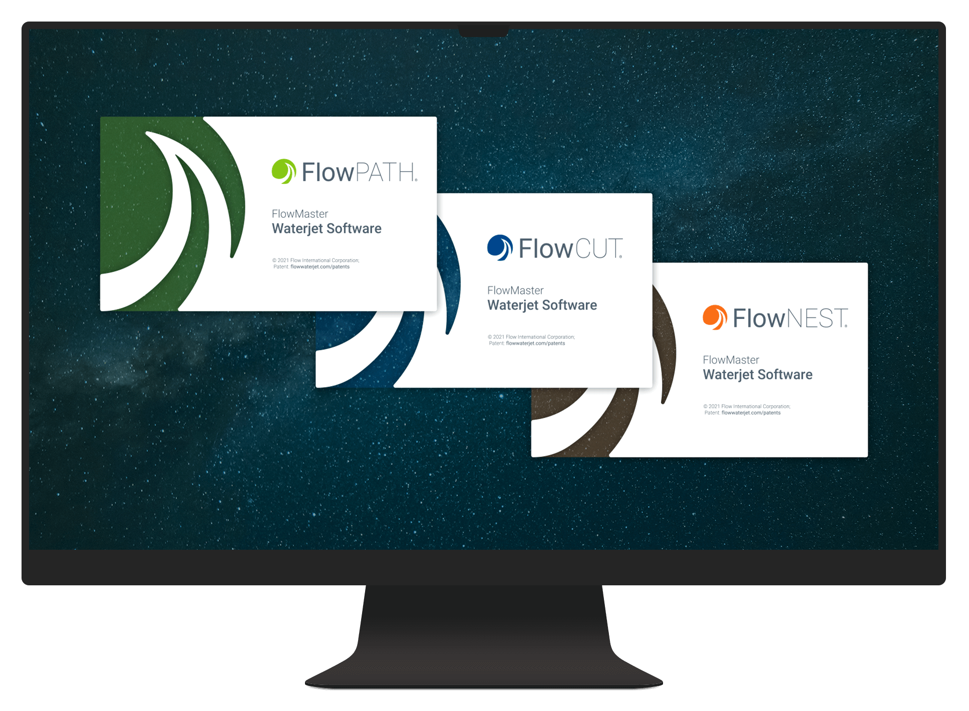

    The FlowMaster, Simple Yet Powerful, software suite combines everything you need to design and cut your 2D waterjet parts.
    desktop computer monitor featuring FlowCUT, FlowNEST, and FlowPATH splash screens
    screens from the FlowCUT software

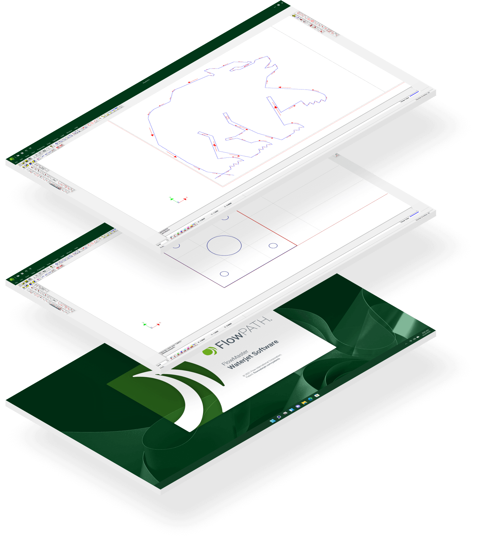

    screens from the FlowPATH software
    FlowPath®
    FlowPath takes the guesswork out of making high quality parts regardless of operator skill level; No G-code required.
    • Import your 2D file or create your own design
    • Examine the drawing to detect any geometry errors
    • Select the geometry and autopath, the system automatically creates lead in, lead outs, and traverse lines
    • Many other waterjet specific features available at the touch of an icon
    • Save the ORD and send the file to the machine, FlowCut does the rest
    Intuitive Interface
    Intuitive graphical interface simplifies the creation and design of parts. Easy-to-use CAD drawing and editing tools, context-sensitive tool tips and integrated users guide in the Help section.
    Waterjet Knowledge Built In
    Leverages Flow’s 40 years of waterjet application expertise. Incorporating Flow's best practices to estimate what steps are needed to create the best part. SmartStream™ cutting models assure high-quality finished parts with smart pathing powered by Flow application expertise.
    Optimize Your Process
    Unique modifiable tool path generation with automatic lead-in and lead-out and rapid traverse lines. Part tabbing function for user to choose location, gap, and length of entry and exit points for a part tab.
