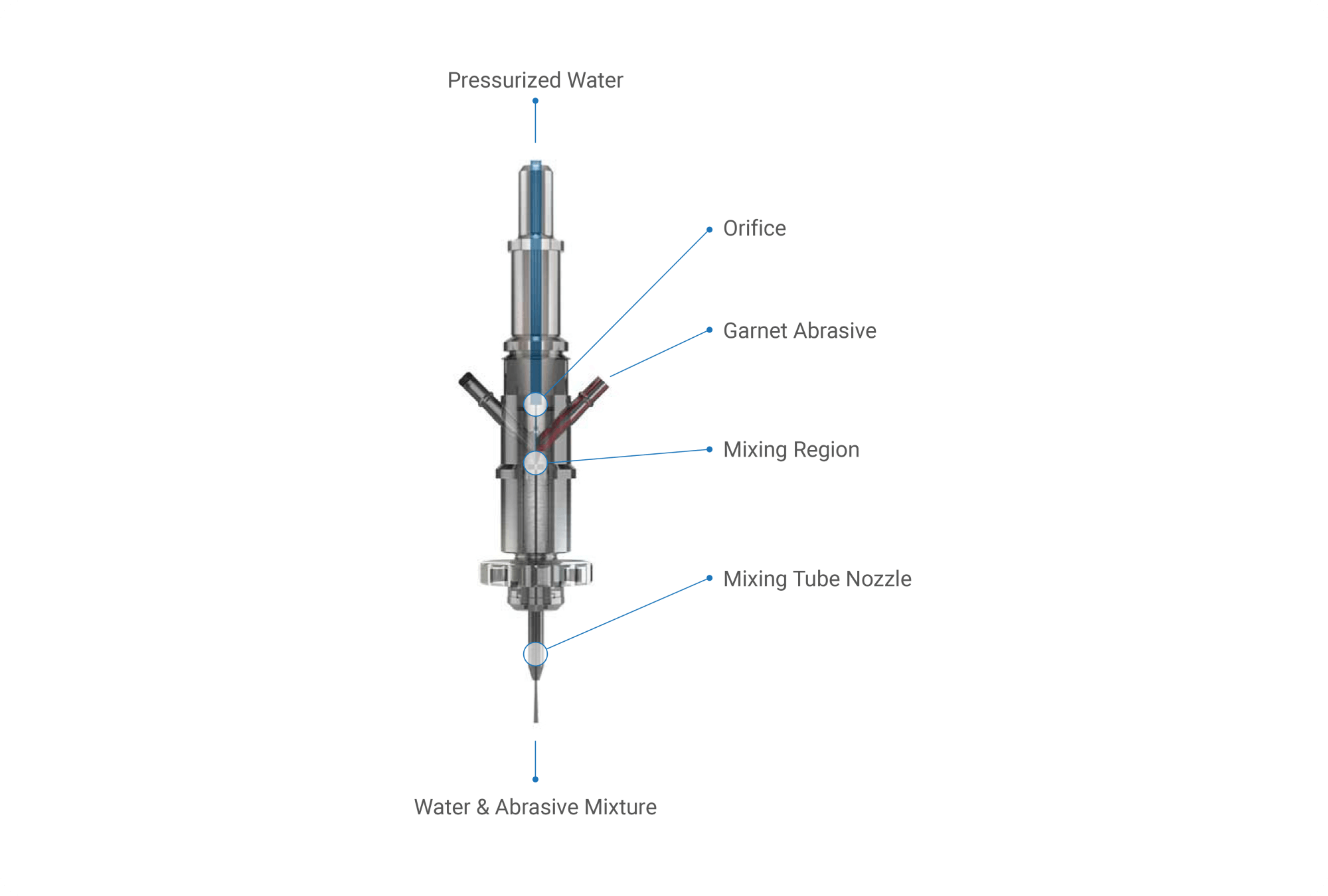

    In 1980, Flow stepped in to create high-velocity, sharp-edged particles capable of cutting metals and hard materials. This was known as Abrasive Waterjet (AWJ) and required higher-pressure pumps to achieve the desired abrasive particle velocities.
    waterjet entrainment process

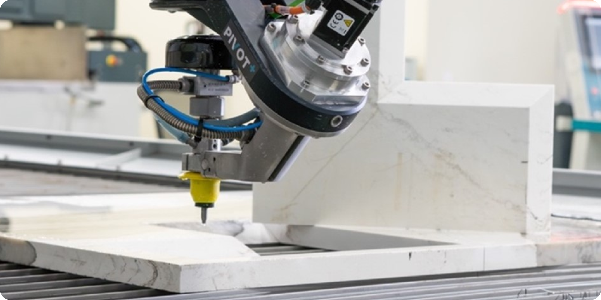

    waterjet cutting stone

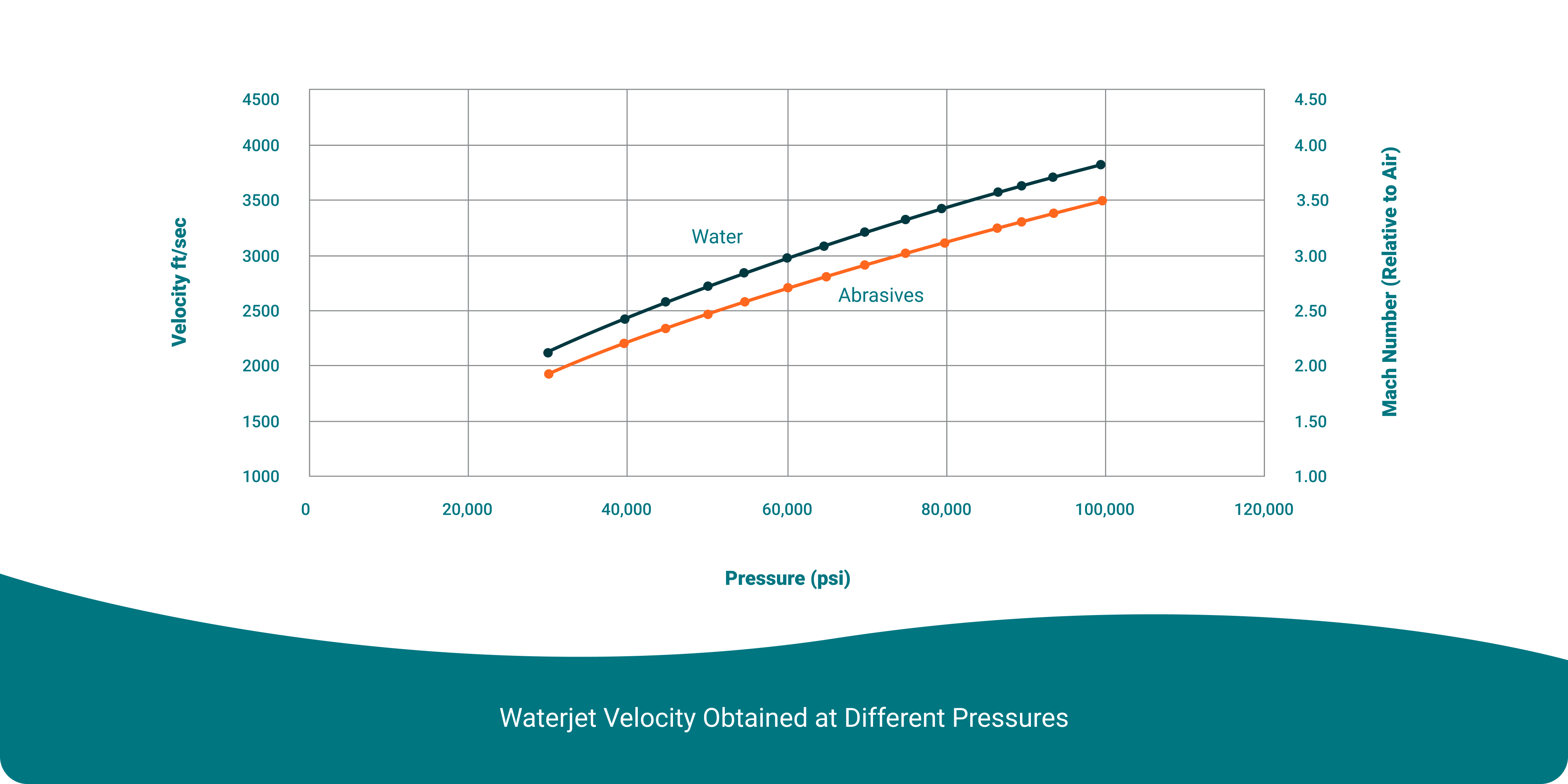

    As technology advances, we can use higher pressures to achieve higher velocity jets. Water and relatively softer abrasives can penetrate harder materials due to shear rate of impact, or velocity, like how a straw can penetrate a tree in a hurricane. Check out the figure below to see how waterjet velocity can be obtained at different pressures, as well as the abrasive particle velocity if we add 10% abrasives by weight to the waterjet.
    waterjet velocity by pressure graph
    One of the most important motivations to increasing the velocity is to reduce the quantity of abrasives needed, as they are the highest cost item. By increasing the velocity, we will need less mass. On the other hand, if a user wants to operate at lower abrasive velocities (and thus a lower pressure pump), then they must compensate for the reduced velocity by increasing the mass of the abrasives, which will increase operational cost.
    With pumps operating reliably at 90,000 psi, increasing abrasive particle velocity is beneficial for reducing consumption, therefore saving money. So next time you go to Home Depot to rent that pressure washer, pick the one with the highest pressure rating. Better yet, if you buy a waterjet machine, buy the one that gives you the highest pressure so you can do your job faster and save on your bills.
