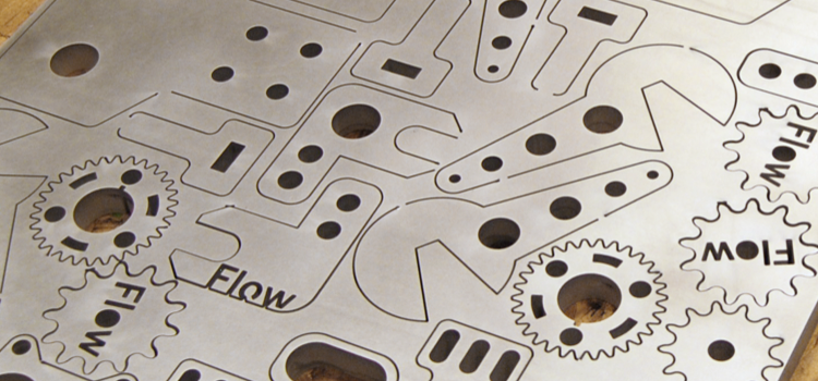

    Water pressurized at 60,000 psi easily cuts through gaskets, foam, soft plastics, and rubber. When sand is added to the pressurized water – known as abrasive waterjet cutting -- the process can cut through almost any material, including metal and stone.
    Waterjet cutting is accurate, can be used on numerous materials up to 24 inches thick for rough cuts, and doesn’t require secondary finishing as it doesn’t create any heat-induced stress or markings on your finished product. Water jetting is a cold-cutting process that leaves a satin smooth edge on your materials and creates minimal kerf.
    Waterjet cutting with minimal kerf
