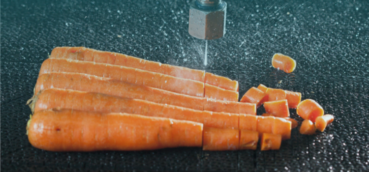

Although the picture is of pure waterjet cutting carrots, I’m going to focus on abrasive waterjet cutting applications in this post. Fixturing requirements are different in pure waterjet cutting, partially because the material is often very light and the jet forces are an order of magnitude (10x) lower compared to abrasive waterjet.

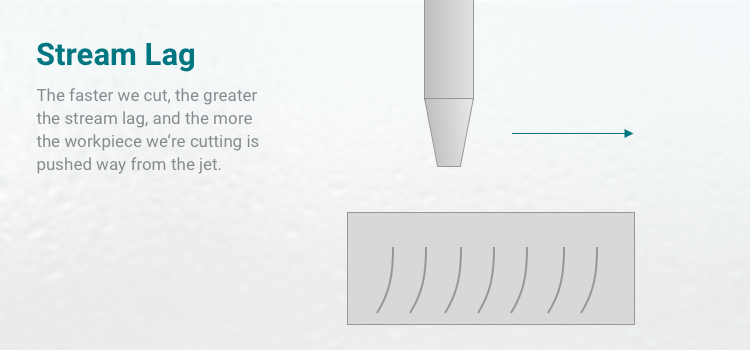

Operators are most concerned with the lateral force because this force tends to want to push the material away from the direction of travel. The faster you try to cut the part, the greater the lateral force. That’s because the stream lag is greater as you cut faster. The jet is being forced to curl backwards and the equal and opposite force is going to try to push the part away. The smoother the edge we want, the less stream lag we will allow, and the lower the lateral force.

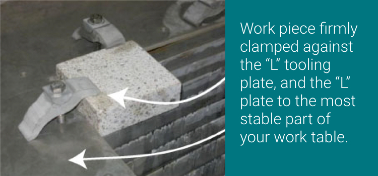

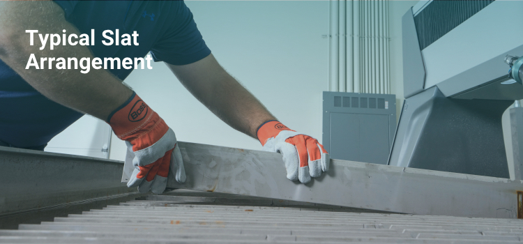

The main clamps you intend to use to hold the part stable should be attached to this aluminum or stainless “tooling plate,” not the slats. You can certainly add secondary clamps coming off these wobbly slats, as long as you first had the main clamps coming from the very solid tooling plate. Make sense? I hope so. Our customers have come up with thousands of ways to fixture parts, and your application might force you to get creative. But in general, this is how it is done. For extremely high tolerance cutting, such as 0.002 inch (0.05mm) or tighter, then more advanced tooling as seen on an EDM or Milling Machine would be in order.
