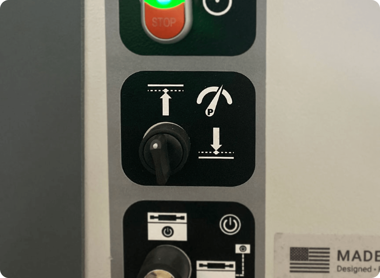

    close up of dual pressure control dial on the side of the HyperJet waterjet pump
    Dual Pressure Control
    Designed for applications where a low pressure pierce may be necessary before a higher pressure cutting operation, the dual pressure control provides a simple way to switch between two output pressures.

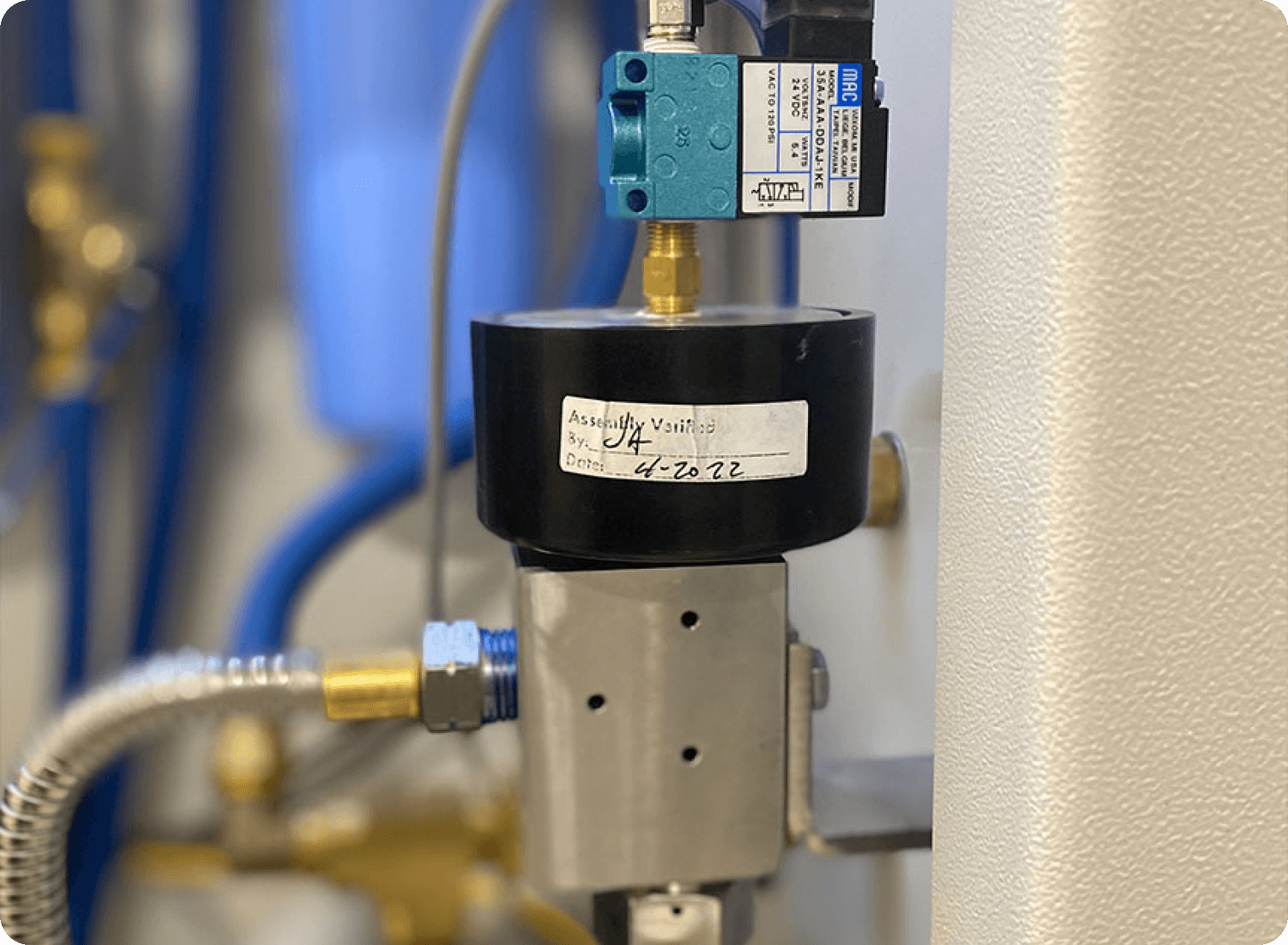

    Interior view of waterjet pump showing built-in safety mechanism
    Built-In Safety
    Automatic high-pressure bleed-down valve relieves system water pressure to 0 psi [0 bar] within one second of shutting down the pump. When the pump is powered down or the emergency stop is activated, solenoid valves automatically shut off both the filtered water and pump cooling water. This option overrides automatic cooling water flow control and maximizes water savings.
